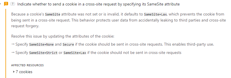

Looking at the dev tools I found this message:
According to this article (https://support.esri.com/en/technical-article/000022568) this should have been resolved. Any words of wisdom?
Hey @codergrl did you ever figure this out or hear from Esri? We are seeing very similar errors in our console for apps deployed to our servers created in Web AppBuilder Developer... and our organization is apparently rolling out the Chrome update that will make SameSite / Schemeful cookie blocking default / mandatory. I'm unsure if this will have any detrimental affect to users of our apps or not at this time. Thanks for any info you can provide!
