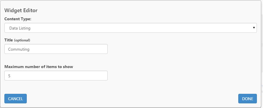

I've successfully accomplished everything from "Prepare Your Data" to "Data Report".  The next step on this help page, "Design the layout of your open data site" is where my attempts at self-education hit a big stubborn wall.  We are wanting to group our data like the MD group has:  . http://imap.maryland.opendata.arcgis.com/   I imagine this is possible buy creating an "image widget" with a link to some content on our Open Data "Home Page", but how do I create the actual page where all of the datasets will be listed and previewable, such as this:  http://imap.maryland.opendata.arcgis.com/datasets?q=Agriculture ?  I tried creating a "data listing" widget, but all I get is this.Datalisting.JPG
I would like to create a Commuting listing that will provide links to our commuting datasets that we uploaded to ArcGIS.com months ago.  When I hit done, all I get is a widget with a endlessly spinning circle:

The data listing widget will show the most recently modified datasets. Unfortunately it is not possible to set specific datasets to appear in this widget. If you preview your site you will see the dataset listing widget working. The problem with the dataset map widget is a known bug.
To have a category for your Commuting data, you can use the image widget (or include an image within the text widget) and add a hyperlink to a search query. Make sure all your Commuting data has a "Commuting" tag (edit in ArcGIS Online), and then they should all appear when you search "Commuting" in the search bar of your site. Copy that search query from your URL into your editor so the image links to the query.
