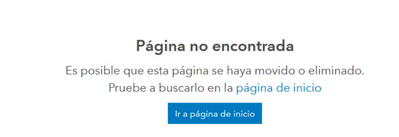

I have a similar issue. Not sure if it is the same. But the first time I go to the open data site, and open a map, it works well. Then, when I go back to the page and refresh, I get the 404 error. But it is strange because this error happens sometimes. We tried on different browsers, and some people got the error, while other didn´t. Why is this? and how could I fix this?
