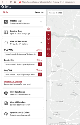

@EnvironmentAgency if you click on "View API Resources" the GeoService option shows the server URL with a button to copy and a link to View.
Is that what you are looking for?

Map image layers and vector tile layers don't have the "View api resources" dropdown available.  This is expected, but on the item overview page on the portal a REST endpoint does exist in the url field.  It would be very useful to be able to expose this to the users within the site application.
Feature Layers and image services do have the "view api resources" menu visible, but having looked at it more closely after your helpful post I've noticed that the url appears to be incorrect.  You may well have helped me spot a bug.  I'm using Enterprise v11.1.
Expected url would be:
https://<portal  url>/server/rest/services/<folder name>/<service name>/FeatureServer
Instead, in the GeoService field I am seeing:
https://<portal  url>/server/rest/services/<folder name>/<service name>/FeatureServer/0/query?outFields=*&where=1%3D1
The appended query string at the end of the url seems to be consistent across all feature and image services.
I'll get this raised as a bug with support, but exposing the url for map image and vector tile services would still be extremely beneficial.

If you click "View Data Source" does that take you to the REST endpoint you need?
