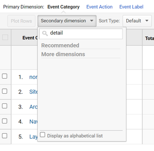

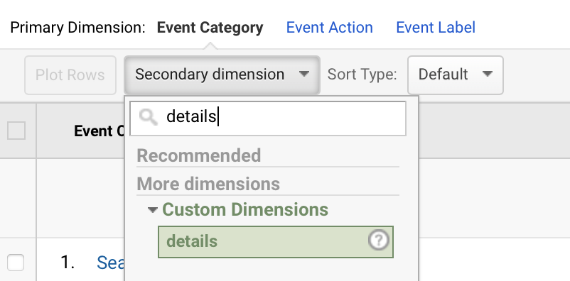

@Kevin_Peel you'll see see the primary dimensions at the top of the "Top Events" table, below you'll see a dropdown called "Secondary Dimension". Open this dropdown to search and apply custom dimensions.

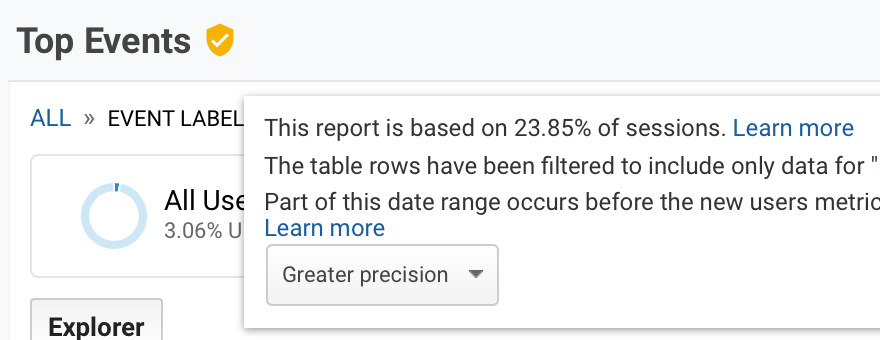

If you are not paying for a premium plan of Google Analytics, then your query will be sampled which may impact the accuracy of reporting depending on the sample size. You'll see this noted in the shield icon next to the dashboard header.

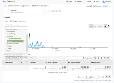

Hi @BrianRollison, do the custom dimensions show up on its own, or do we have to set them up in GA? For example events/goals/views/tag manager etc. Sorry, first time using GA, but want to find out download number for each dataset.

I was able to add Custom Dimensions in Google Analytics, using this Google Analytics Help page.  Not sure if this is the right way to do this, or if I did it right.
When I try to go from Behavior -> Event -> Top Events ->  Engagement -> Download ->
And under the Custom Dimensions dropdown, select Secondary dimension: id, no results are shown.
I'm so confused and appreciate any help!
