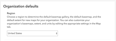

Organization > Settings > General (using account with appropriate permissions, e.g., Administrator)
Set Organization default > Region to United States.
Update the Maps and Scene settings as desired (as needed, you can still change the default extent to be global).

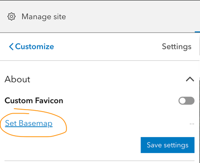

Open the Hub site (using account with appropriate permissions) and choose Edit layout, then select Settings from the Customize side panel.

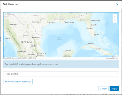

Select Set basemap

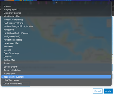

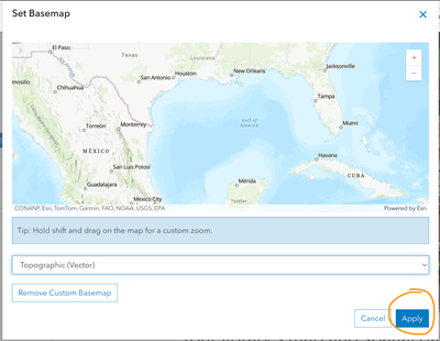

From the drop-down menu, choose “Topographic (Vector)” as the custom basemap.
Apply the change:
Then Save settings:

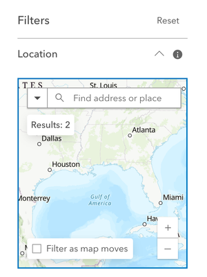

The updated basemap is now applied to the catalog location map facet (/search), details view (/about), and explore content views (/explore).
TIP: To set the site extent, for example to zoom in on the US in the location map facet, go to Manage site and update the Location in the site Details, or in the ArcGIS Online item settings. This will also make your site discoverable by search engines using location-based search!
