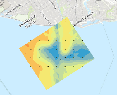

I'm trying to figure out how to orient the model to my grid of data. I'm trying to plot data from a CTD and auxiliary instruments (CDOM fluorometer specifically), but somehow the top of the rectangle appears with the top to the North. Is there a way to adjust the orientation so it fits my grid of stations better? I tried setting the processing extent to the data table and that froze up Pro.

@Matteroffact I may not be understanding correctly, but I don't think it is possible to do this with the 3D geostatistical layer.  The layer will always be a full cube oriented by the coordinate system.  However, there are many more options when exporting the results.
GA Layer 3D To NetCDF tool (used to prepare a voxel layer) has an "Input study area polygons" parameter that lets you define a non-rectangular study are for the export.  GA Layer To Multidimensional Raster tool supports the Mask environment, which can achieve a similar result.

@EricKrause OK, so the cube is oriented by the coordinate system, not the data grid? Here's a picture to help clarify my predicament.

I will use the tools you mentioned if there's no other solution. Thank you
EricKrause
@Matteroffact Yes, that is what you should expect to see with the geostatistical layer.  However, think of the geostatistical layer as more of a model source and visualization.  It draws itself within the rectangular extent of the points (oriented by the coordinate system), but the results of the model are defined everywhere, and they can be exported within and/or outside of drawing rectangle.
