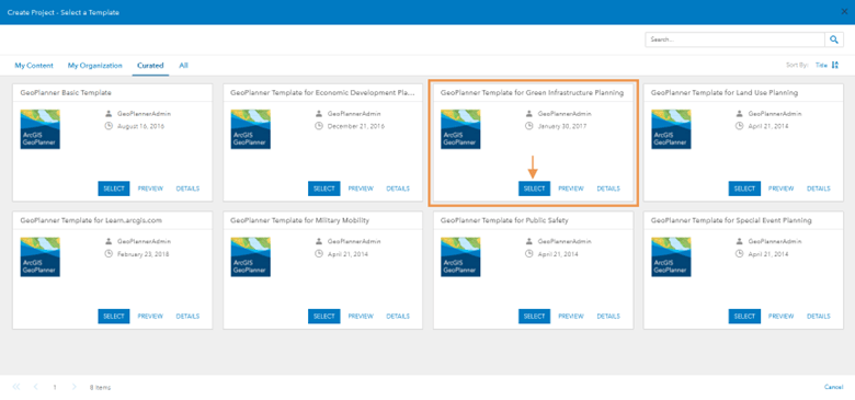

Step 1 – Browse to https://geoplanner.arcgis.com/ in a browser and sign in with your ArcGIS organization account.
Step 2 – Click the Create new button to create a new project.
Step 3 – Look for the GeoPlanner Template for Green Infrastructure Planning and click the Select button.
Select a template to create a project. The tab that contains the templates is labeled Curated if you are using ArcGIS Online and Built-In if you are using ArcGIS Enterprise.Select a template to create a project. The tab that contains the templates is labeled Curated if you are using ArcGIS Online and Built-In if you are using ArcGIS Enterprise.

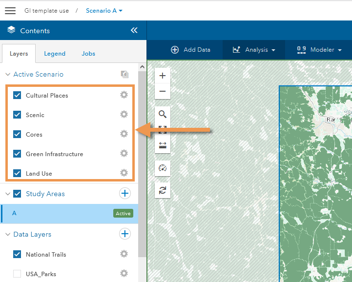

Step 4 – Review the Active Scenario section in the Contents pane. These are the scenario layers and are sometimes referred to as design layers because they house the features that you create on the map for your design.
The green infrastructure template has built-in scenario layers.The green infrastructure template has built-in scenario layers.

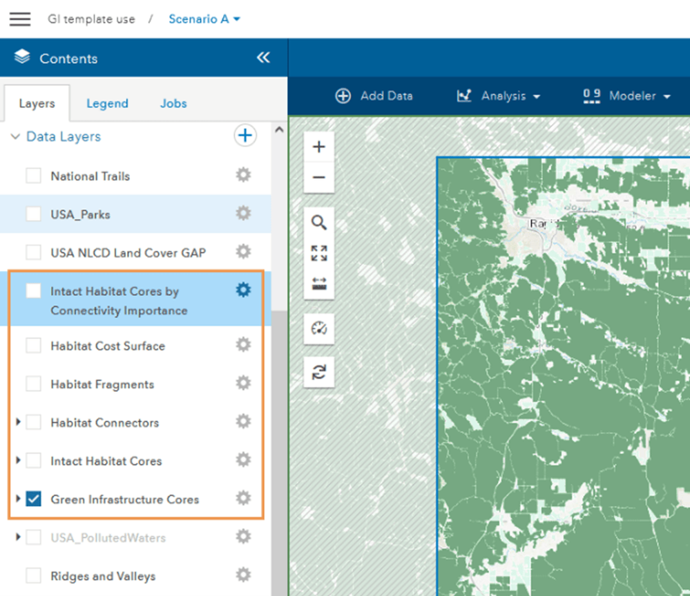

Step 5 – Review the Data Layers in the Contents pane to learn what kind of data sets are included with the green infrastructure template.
The ArcGIS GeoPlanner green infrastructure template includes related data sets.The ArcGIS GeoPlanner green infrastructure template includes related data sets.
Among the datasets included in the template’s Data Layers are five that were generated as part of Esri’s Green Infrastructure initiative: Intact Habitat Cores, Habitat Connectors, Habitat Fragments, Habitat Cost Surface, and Intact Habitat Cores by Betweeness.

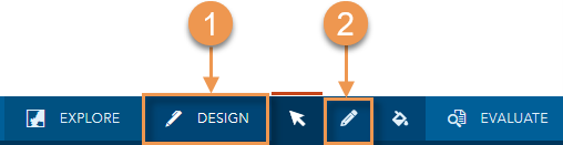

Step 6 – Click the Design tab to open the design tools and click the pencil icon to review the included preset feature symbology.
Click the Design tab to bring up the Draw tool.Click the Design tab to bring up the Draw tool.

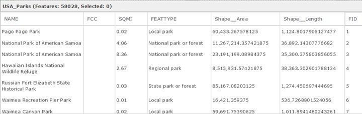

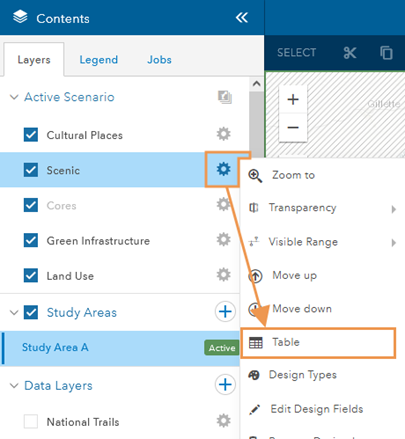

Step 7 – From a corresponding scenario layer, open a scenario layer’s table to see attributes, or fields, for the features you add on the map.
You can access a scenario layer's table from its Options icon.You can access a scenario layer's table from its Options icon.
These attribute fields are also included with the template, and you can easily add more design fields to meet your organization’s needs as well. Some data layers, such as feature services, also have a table on which you can review features and their attributes.
Open a scenario layer's table to see its features that are currently on the map and their attributes.Open a scenario layer's table to see its features that are currently on the map and their attributes.

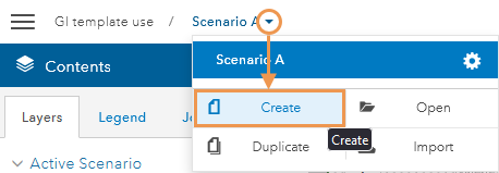

Step 8 – Create a new scenario to which a data layer can be imported and modified.
You can create, open, duplicate, or import scenarios from the Scenario drop-down arrow.You can create, open, duplicate, or import scenarios from the Scenario drop-down arrow.

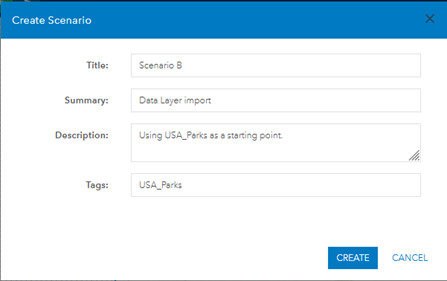

Step 9 – Fill in the new scenario’s details and click CREATE.
GeoPlanner allows you to compare multiple scenarios in one project so you can visualize proposed changes. This can be useful when considering how changes will impact existing green infrastructure, for example, Green Infrastructure Cores. These are minimally disturbed natural areas at least 100 acres in size and greater than 200 meters wide.
When looking at the map in GeoPlanner’s green infrastructure template, an organization can turn the Green Infrastructure Cores data layer on to note boundaries while working on changes to another layer. For example, say the USA_Parks data layer needs to be expanded but remain within the boundaries of the cores. The green infrastructure template in GeoPlanner contains both layers and by importing USA_Parks polygon to modify it, you can bring it into your scenario layers and make tweaks.

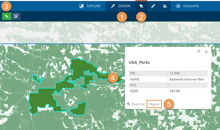

Step 14 – Click a feature from the USA_Parks data layer and in the pop-up that appears, click Import.

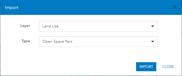

Step 15 – Use the drop-down arrows to specify which scenario layer the feature should be imported to and what type of feature it is. Then click Import.
Import Data Layer features into your design's scenario layers.Import Data Layer features into your design's scenario layers.
The feature is imported into the scenario layer that was specified and you can now make adjustments to it there.

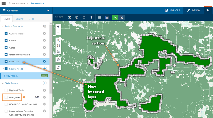

Step 16 – Turn off the USA_Parks Data Layer as it is now a duplicate, and use the selection tool to double-click the imported feature on the map.
Using the selection tools, you can double-click on an imported feature to bring up its vertices and reshape it.Using the selection tools, you can double-click on an imported feature to bring up its vertices and reshape it.

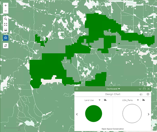

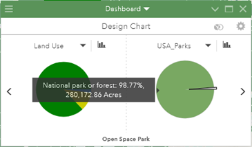

Step 17 – Click the Dashboard icon on the map.
The Design Chart appears. The primary left side shows what the scenario layer specified contains. Currently, the imported USA_Parks into the Land Use scenario layer as Open Space Park is the only item, so our Land Use scenario layer is 100 percent Open Space Park.
The Data Layer that was imported into your design as a scenario layer is 100 percent Open Space Park.The Data Layer that was imported into your design as a scenario layer is 100 percent Open Space Park.

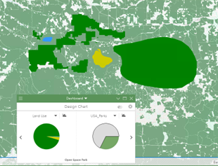

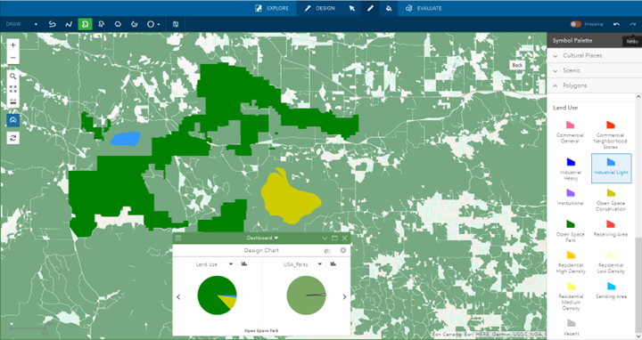

Step 18 – Add more features to see the primary chart update in real time.
Draw more features using symbology from the symbol palette and see how charts in the Dashboard are impacted.Draw more features using symbology from the symbol palette and see how charts in the Dashboard are impacted.

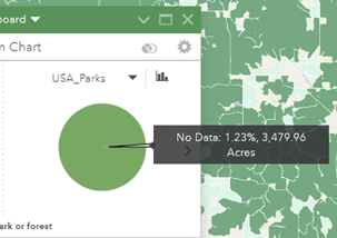

The secondary chart on the right of the dashboard further breaks down the type that is clicked in the primary left chart. For example, in the previous image the Open Space Park category was selected in the left chart, by hovering over the right chart, I can see that 98.77 percent is national park forest and there is no data for the remaining area (1.33 percent). The USA_Parks polygon serves as an underlying assessment layer.
98.77 percent of the Open Space Park feature consists of national park or forest.98.77 percent of the Open Space Park feature consists of national park or forest.
Hover over other slices to see more information.Hover over other slices to see more information.
If more Open Space Park that cover regions without data is drawn on the map, the secondary chart updates automatically.
The design update is reflected in the Dashboard charts.The design update is reflected in the Dashboard charts.
