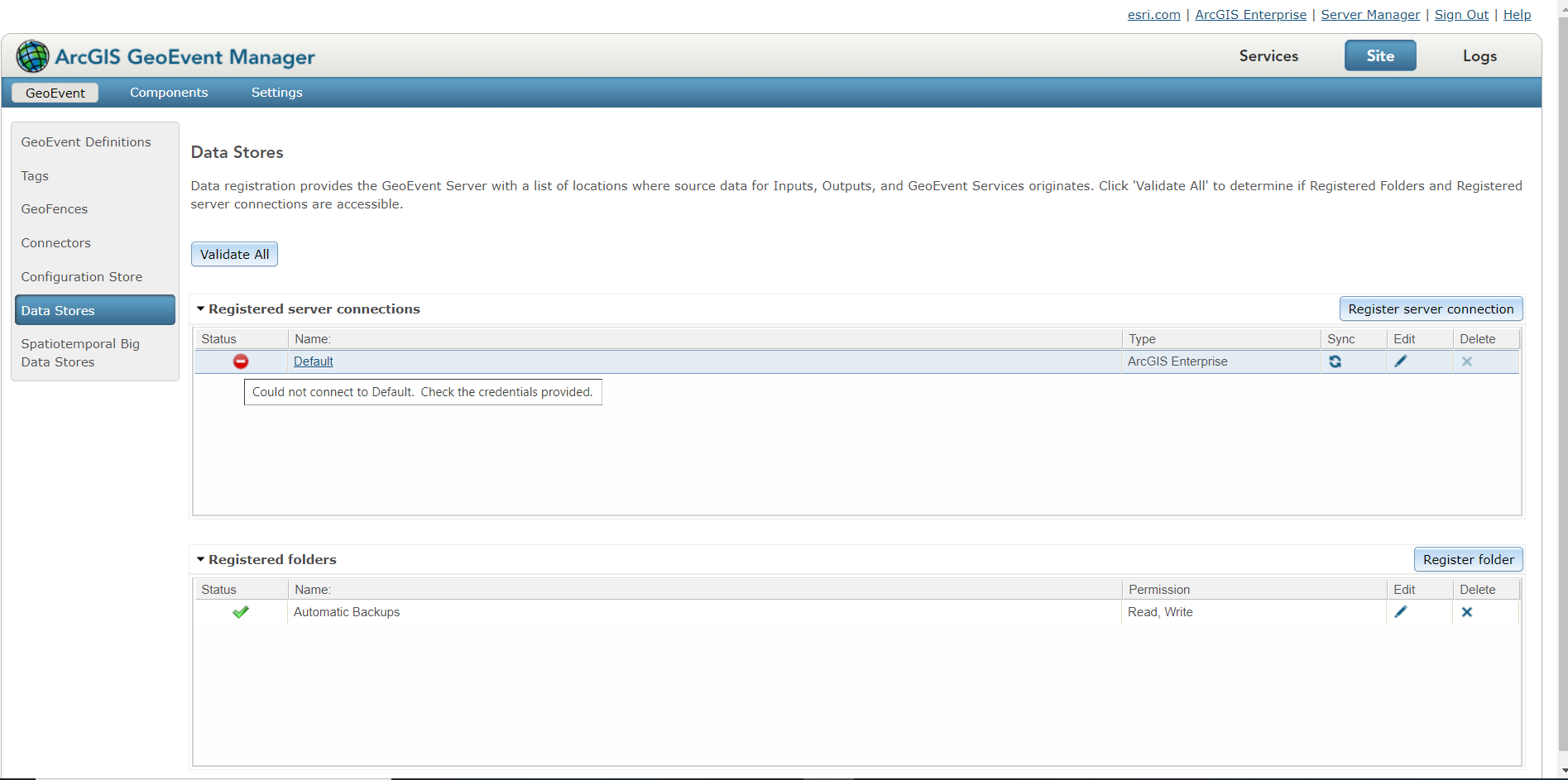

Geoevent Manager's site page has an error status for "Default" under "Registered Server Connections":
How do I get the Status to validate successfully?

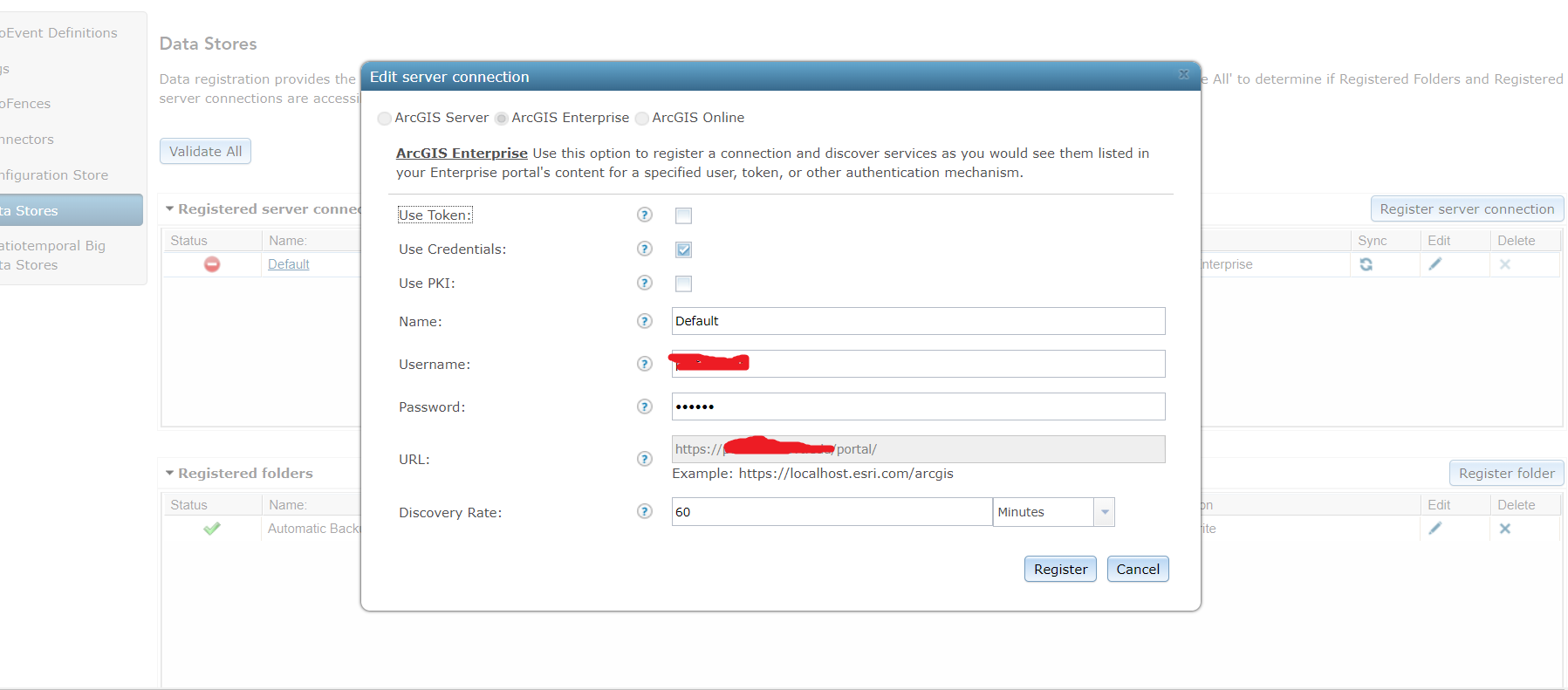

1. I tried clicking "Edit", then checking "Use Credentials" and entering the main portal admin user's credentials.
2. I checked the credentials by logging into portal directly successfully.

I triggered a validation of the "Registered Server Connections" by clicking the link "Data Stores" on the left and also hitting "Validate All". Then I clicked the Logs link and saw the error:
An SSL Handshake error has occurred when attempting to communicate with URL: "https://ourPortalServerUrl:7443/arcgis/sharing/community/self?f=json&token=encodedTokenTextHere.". Please make sure you have imported the SSL certificate from "https://ourPortalServerUrl:7443/arcgis/sharing/community/self?f=json&token=encodedTokenTextHere." into GeoEvent's site via the ArcGIS Server Admin API. Root Cause: "PKIX path building failed: sun.security.provider.certpath.SunCertPathBuilderException: unable to find valid certification path to requested target".

4. Navigate to the GeoEvent "Data Stores" page. It now shows a green checkbox for the "Default" server connection.
