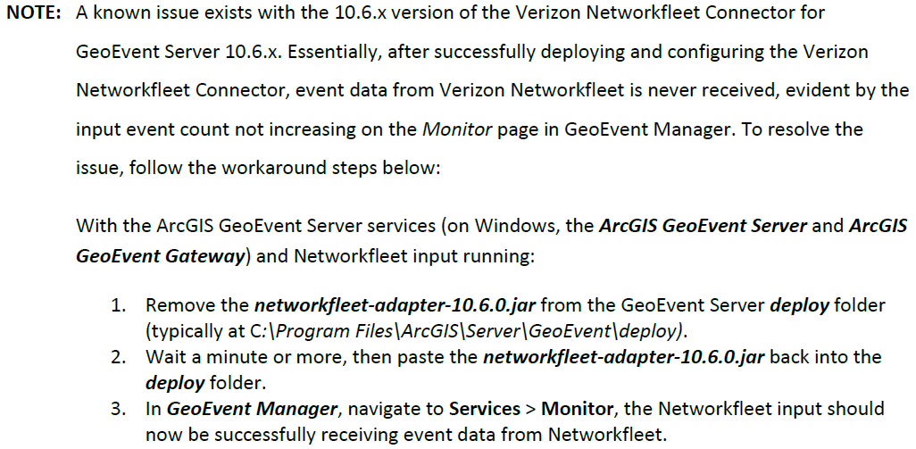

We had a power outage about two weeks ago, and while we aren't in a heavy GeoEvent use time - I did note that our street sweepers were not updating.
When I logged in to GeoEvent Manager I noted the red exclamation mark next to the Networkfleet-Connector Input.
Did some digging and recalled the 'bug' fix in the  Verizon NetworkFleet install PDF  screen shot below.
Followed those instructions, but that didn't do the trick.  Below is the error message, initially I thought is was an access right, but the service user has rights?
In full disclosure, I don't recall the error messages prior to trying the fix above.  And we have not attempted a full uninstall/reinstall - I'm not keen on that as, well - in my experience that never goes well for me
If we do try re-install - is there a way to create a backup or copy of all of our Services?
Thank you in advance for any input!
