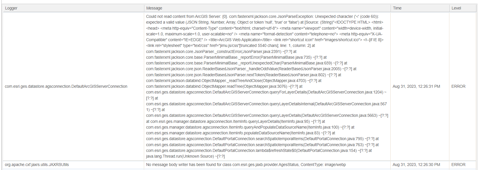

I'm having an issue with my GeoEvent environment post upgrade to 11.1 from 10.9.1 in which the default enterprise data store returns the following errors upon refresh:
LOGGER : com.esri.ges.datastore.agsconnection.DefaultArcGISServerConnection
Could not read content from ArcGIS Server: {0}. com.fasterxml.jackson.core.JsonParseException:
Unexpected character ('<' (code 60)): expected a valid value (JSON String, Number, Array, Object or token 'null', 'true' or 'false')

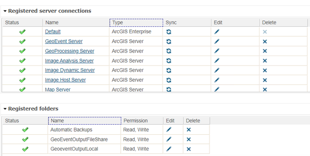

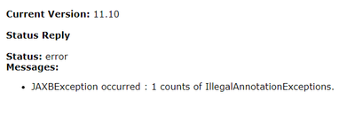

The admin connections page says the following about the default enterprise connection:
I have reset GeV configuration completely, without any configuration and have configured only the default connection to enterprise and I have tried:
  • creating a new user for this connection with no content and using for data store
  • using the PSA for the data store credentials
  • administrative reset of geoevent server
  • uninstall and re-install of geoevent server
  • unregistered spatiotemporal BDS with Hosting Server
  • performed repair operation on ArcGIS Server licensed with GeoEvent
Has anyone seen anything similar to this issue before?

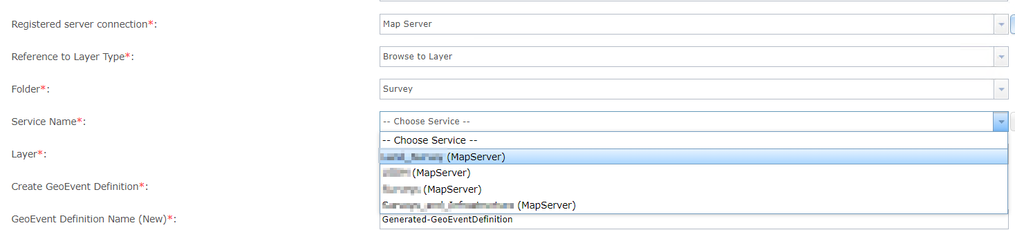

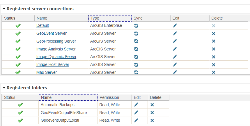

## Edit 2023-09-07 : I forgot to mention that this issue occurs even when all data stores validate  successfully, and imported existing geoevent services / inputs and outputs all work as expected also (I would usually only have the "Default" connection registered, but have connected individual servers to confirm they are accessible):
Poll an ArcGIS Server for Features:
DeanMoiler
An update to the admin page data store connections which is now logged as a bug:
