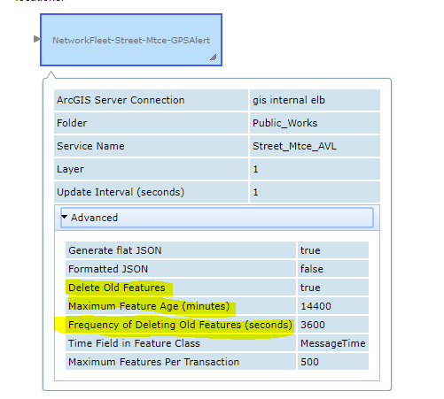

Hi Erik
We typically use two methods to control this data. 1) The Advanced settings of your Geoevent output enables you to Delete Old Features and set the age of those features to truncate. 2) We make regular backups of the feature classes, so we don't ever completely lose that old data.
A specific scenario might be snow plows. We typically get snow between November and March. We create daily backups of the snow plow AVL feature classes during that period by copying them into file gdb's and zipping those gdb's (might be overkill - could get away with less frequency) using Python scripts. Then we set the Advanced properties on our Geoevent output to only keep the data we need to use for public snow plow maps and internal analysis. We can always go back to an archived copy of the data if we need to use it.
