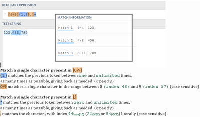

I like the RegEx you used in the Field Calculator (Regular Expression). Your pattern match – (,[^,]{0}) – is very tight and well crafted. I do not use that variant of field calculator as often as I use the "regular" Field Calculator with its replaceAll( ) function, which changes how I think about regular expression pattern matching. A regular Field Calculator also allows me to combine operations in a single expression. I tried combining the string replacement and length operations with a slightly different RegEx. I'm not sure that all of the Field Calculator's supported functions can be combined this way, but it appears to work in this case:  length(replaceAll(DataString, '[0-9]{1,}[,]*', 'x'))
The above RegEx matches one-or-more digits (zero to nine) with a trailing comma (if one exists) and accepts a final numeric identifier without a comma as the last in the delimited list. Each identifier is replaced with a single literal 'x' so that the length( ) function can simply count the number of x characters. Seems to work for empty string (""), single identifier ("12345"), and multiple identifiers ("689102,0256,651,74290") ... returning lengths of 0, 1, and 4 respectively.

The pattern match you propose [0-9,a-z,A-Z] should work for a mix of letters and numbers. The pattern specifies any single character, lower-case or upper-case letter or digit. The repetition qualifier {1,} specifies one or more repetitions matching this pattern.
You could try using the \w metacharacter which specifies "Any Alphanumeric character". But your pattern is essentially the same thing.
I use the online utility https://regex101.com to develop and test my regular expression patterns. Another good site offering a RegEx tutorial is https://regexone.com
There are different flavors of RegEx, so to be careful I would select 'Java 8' in the regex101.com web tool's left-hand options frame. That site is nice in that it explains why the pattern match is matching the way it does. All you need to recognize then is that the function expression you configure your GeoEvent Server's Field Calculator with has three parameters:  The data field, the pattern to match, and the replacement for every occurrence of that pattern (in this case a single literal character 'x').

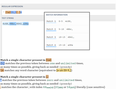

Two examples from https://regex101.com

@RJSunderman Wow, that was a complete guess on asking about [0-9,a-z,A-Z], I thought I was making up something wrong!  🙂
I used the \w metacharacter, but it didn't quite do the trick because there are also spaces. BUT, thanks to regex101.com link you sent I could quickly test and figure it out.
Here is the final code, note the space after /w
length(replaceAll(DateString, '[\w ]{1,}[,]*', 'x'))
also, I learned to watch for typos. Note the space between [\w ] and {1,}
length(replaceAll(DateString, '[\w ] {1,}[,]*', 'x'))
