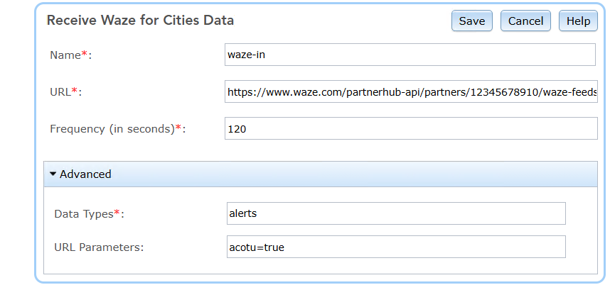

The configuration panel used to enter your Waze Partner URL and request data has been simplified. An example is shown below.
  • Enter a descriptive name for your inbound connector (e.g. replace 'waze-in' with any name)
  • Enter the full URL provided to you from Waze to allow GeoEvent Server to query the API for data:
  • The recommended default rate to query the Waze API for new traffic alerts and jams is 120 seconds. You can set this value as low as 30 seconds, but the Waze API may not respond with data every query.
  • The default query specifies both alerts,traffic data types should be included. It is recommend you choose one (alerts or traffic). If you want both traffic alerts and traffic jams, configure two Waze inputs. The geometry and data schema is different for alerts than it is for traffic jams, and you will need to account for this when configuring processors like Field Mapper to flatten an event record's hierarchical structure.

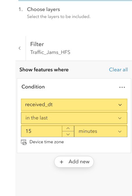

An advantage of using a geodatabase to store the accumulating feature record set is that you can configure a hosted feature layer view to show you only the most recent traffic alerts and traffic jams. This means that as a web map remains open its display will not become cluttered with stale alerts and jams.

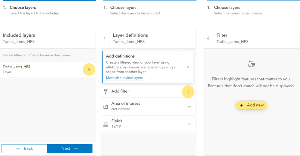

From your Enterprise portal, open the detail page for your hosted feature layer and select Create View Layer. Choose the option to "Create a view of this layer". With the hosted feature layer selected in the Create View Layer configuration panel, click Next to define the filters and fields you want included in the hosted feature layer view.
Click the expansion arrow to add a filter to the view and click 'Add new' :
You will need a date/time field which is updated every time the feature record used to model a traffic alert or traffic jam is updated. This is not part of the data schema included by the Waze API. Refer to the illustrations below for how to use GeoEvent Server to enrich event data records with the needed information. For now, you need to know that a filter expression can be configured for a hosted feature layer view which selects only feature records whose date/time is within the last several minutes :
To complete your hosted feature layer view configuration, click the expansion arrows to collapse the 'Filter' and 'Layer definitions' panels then click 'Next'. Enter a title for your hosted feature layer view, something like "Traffic_Jams_Latest", enter tags and a summary if you wish, and then click Create. You can now add your hosted feature layer view to a web map.
When you configure the feature layer (in the web map) to automatically refresh every 30 seconds (e.g. 0.5 minutes) the view will retrieve and display only the most recent feature records from the hosted feature layer. Note that you will still be required to periodically administer your geodatabase to remove / delete old feature records as data accumulates in the hosted feature layer.

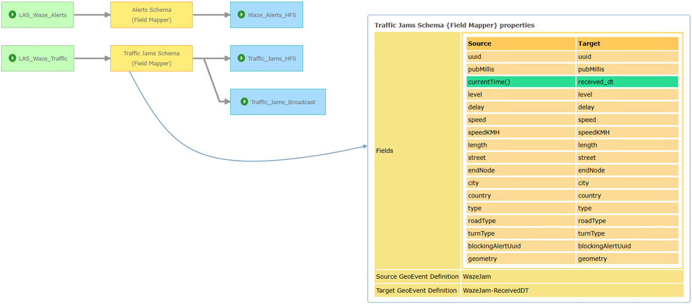

This is done using the same Field Mapper processor you need to configure to flatten a traffic alert or traffic jam event record schema before sending the simplified / flattened data record to an Update a Feature output.

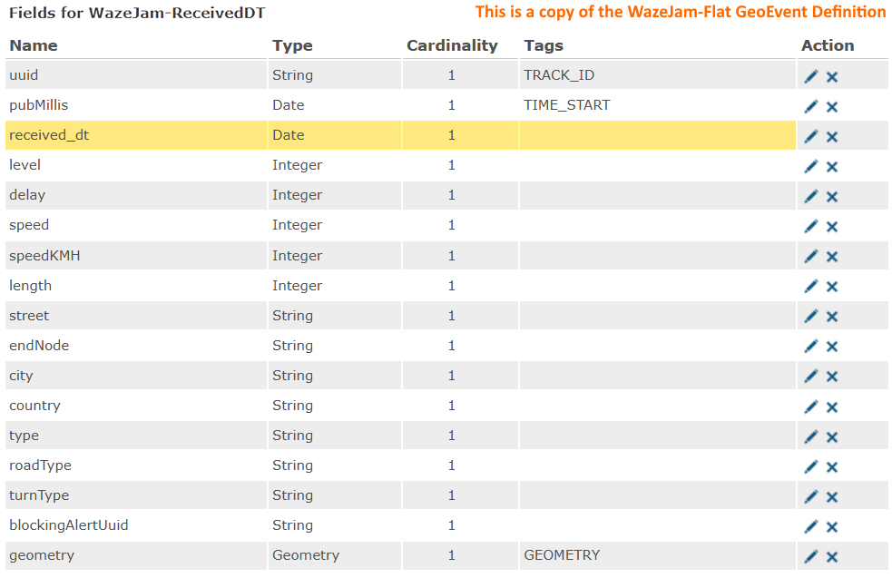

First, you need to recognize that integrating the Esri Sample Waze Connector into your GeoEvent Server added four GeoEvent Definitions to your deployment. There is a GeoEvent Definition named WazeAlert and one named WazeAlert-Flat. The latter omits the X/Y coordinate values nested beneath location and also drops the imageId and the imageURL attributes. New attributes longitude and latitude are added for the coordinate values. A similar pair of GeoEvent definitions are loaded into your configuration for WazeJam and WazeJam-Flat.
You need to create a new pair of GeoEvent Definitions and add a new field which you can use to write a Date value each time a traffic alert or traffic jam event record is processed.
You can easily do this by copying the existing WazeAlert-Flat and WazeJam-Flat GeoEvent Definitions and then adding the needed received_dt attribute to your copy of the event definition. Make sure you specify the data type for the new attribute is a Date.
When configuring your Field Mapper to flatten the traffic jams schema, use the built-in function currentTime() to retrieve the local server's current time and write that, as an epoch date value, into the new attribute field received_dt. Your field mapping should be from WazeJam (the event definition used to adapt the raw data from the Waze API) to the flattened schema WazeJam-ReceivedDT (the copy of the flattened schema to which you added the received_dt attribute).
Hopefully this information helps manage the traffic alerts and traffic jams you process through GeoEvent Server when adding and updating feature records in a geodatabase for display using hosted feature layers and hosted feature layer views.
