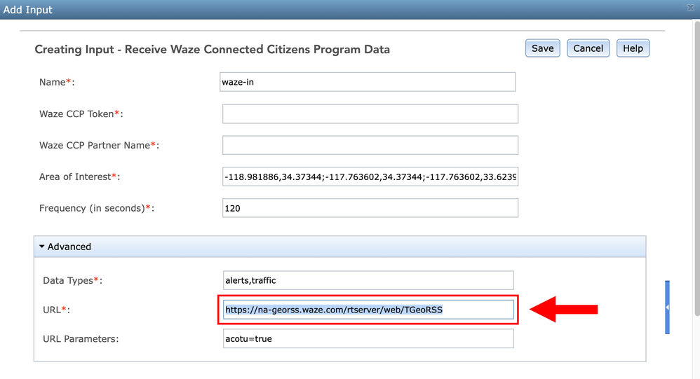

Earlier ArcGIS Releases
Earlier releases of GeoEvent Server may display a version of the input configuration which requires you to enter parameter values for a Waze CCP Token and Waze CCP Partner Name. You can enter the values 'test' and 'test' as shown below. ( These properties are now encoded in the URL provided by Waze. )
