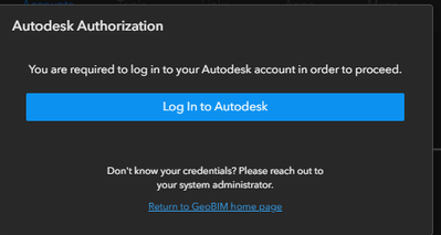

I am trying to configure GeoBIM in Enterprise 11.3, I am gettingan Autodesk Authentication error message
I have followed the installation instructions up to "Authorize the APS application for the Autodesk Construction Cloud account" following the "Scenario 1—Provision Access for Your Own App" link it takes me through a BIM360 process, we are using ACC and none of the steps relate to ACC.

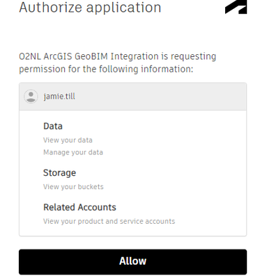

In ACC under custom integrations it is all showing as correct, are there instructions for this part for ACC or am I missing something? We have checked whitelists etc and all appear to be OK, the json file has been updated and the portal restarted. I can create a project no problem, it is at the account step where it is failing. It does ask for this
However as soon as you hit Allow it returns to the GeoBIM page and asked for Authorisation.
Any ideas greatly appreciated
