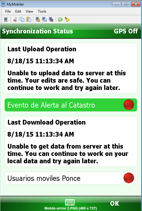

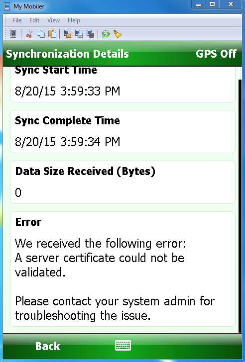

Every time I want to sync my new data I got this error.
I also got this

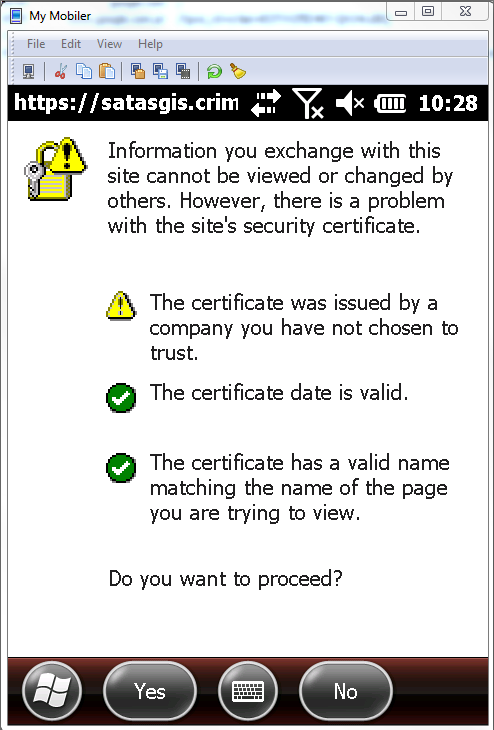

I tried to use a web browser to checked if I can go through the certificate I got this message
Once I clicked I want to proceed I was able to use my certificate.
When I want to sync my data from Mobile I do not have that option to access via https or at least Mobile do not ask me if i want to proceed, as the web browser. I notice in fiddler that it is trying to communicate to my servier but because I do not have that option the sync fails.

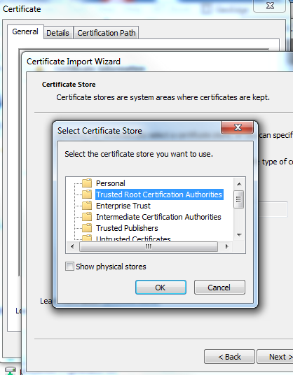

I followed that steps suggested on the web page exporting and installing the certification in the trusted root on the device.
But something is not right because every time I turn off and on my gps and try to access my services using https, I got the same information windows and it suppose to be ignored or pass through because my certificated is already installed as the webpage suggested. I also tried installing ArcGIS Mobile on my desktop and there i am able to sync but not on the device.

Diego, that's helpful, it doesn't look like your certificate should be an issue but can you check the details tab of the certificate dialog that you are in on the above screen shot and say whether it is an SHA-256 (see below). Also, if it is SHA-256 and it's from a Certificate Authority (CA) which it appears to be in your screen shot then it could be an authority that is not trusted somehow. We ran across a GoDaddy cert that Esri GeoEvent Processor did not trust, figured it out through a Esri Support Ticket and had to change the cert type.
