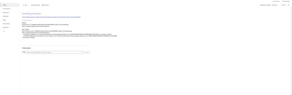

We have the same problem. We've experimented extensively and have established as follows:
  1. We can successfully build a SharePoint website for a client
  2. We can successfully share access to the SharePoint site to an external party outside our Microsoft 365 Organisation
  3. The external party can see and use our SharePoint website but the page containing the ESRI ArcGIS webpart for viewing spatial data generates an error and the webpart is not visible
  4. The allocation of an ArcGIS Data Editor license to the third party has no impact on this
  5. The only way for any person to see and use the ESRI ArcGIS webpart on the SharePoint page is if that person is a subscription member of our MS 365 organisation. This means that they need an MS365 license under our domain. That in turn means that they need an email address under our domain.Webpart error screenshot.pngThat's a screen shot of the error message.
