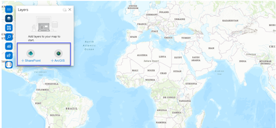

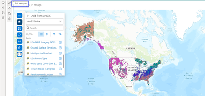

Add layers from SharePoint or ArcGIS.
Note: The data you want to add to your SharePoint is allowed only if the + is enabled. This depends on your data having information such as date, address, longitude, latitude. Most of us know of “geospatial” information like dates and addresses, so that’s a great start!

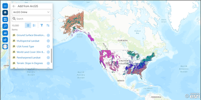

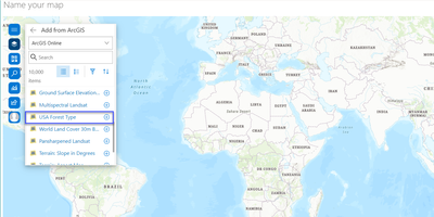

I am choosing USA Forest type. As soon as I add the layers, the data appears on my map.

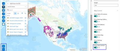

To zoom in/ zoom out of my map, I need to activate those buttons.
Click the  Edit web part pencil icon. In the resulting ArcGIS Maps Appearance pane, I locate Show map controls and toggle the button to the right hand side.

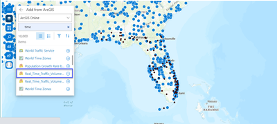

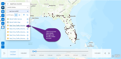

I go back to adding layer options from ArcGIS Online, enter specific search keywords, and choose a dataset with time attributes:

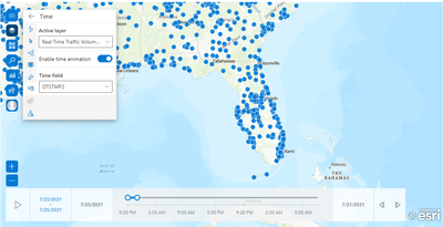

Because this data satisfied the “time” necessity, the Time option is now enabled. I move the toggle for Enable time animation to the right and could not only view the changes in data over time but even customize the time slider to define the time intervals shown.

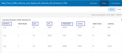

I can also check if the data I added indeed has the time information. For example if I add data from ArcGIS, I can click on the data link to view more details:
It takes me to my ArcGIS Online account where in the Data tab I can see where the SharePoint data is getting the “time” information from:
Note: If you are adding data directly from SharePoint, make sure you have such “time” sensitive information in it. For example, it could be from an Excel sheet.
