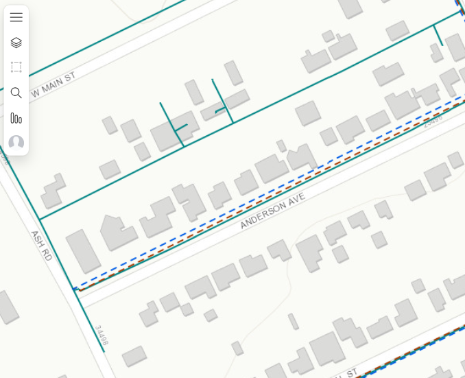

I have a Web Map I am sourcing into Power BI using ArcGIS for Power BI. The Web Map itself utilizes a hosted feature of some pipe data and I set up pop-ups for some basic information regarding the data. How do I get those pop-ups to show in the map via Power BI?
The map itself seems pretty limited in terms of how to interact with the features.

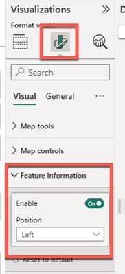

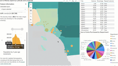

Thanks for your question! @RClavero is absolutely right! To view the pop up of the ArcGIS layer, you will need to toggle on Feature information from the format pane.
Then you can view the information on the side panel.
The reason why we do this is to not block your map. If the popup shows on the map, it will take lots of space from your map.
