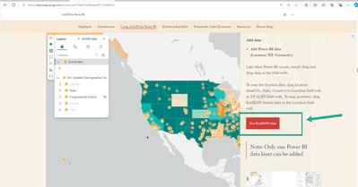

Thanks for your question! If you prefer a non coding solution, check out this link https://storymaps.arcgis.com/stories/dc0c7f9ab73c469aaea407213d0883a1 . If you go to Using ArcGIS for Power BI part and keep scrolling, there's an Add data part explaining how to get EsriJSON data and there's a short video demonstrating how to map the geometry data.
