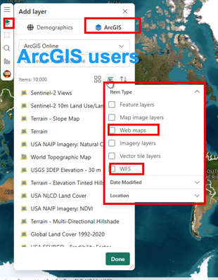

ArcGIS for Power BI supports web maps and WFS for ArcGIS users. You could add the layers from + ArcGIS data from Layers tool.
Please let me know if you have any other questions. Thank you!
