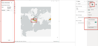

Hi Guys,
I need small help here. I am unable to get layer information on power bi interactive map. Earlier I used to get information about layer generally for ArcGIS layers for hurricane event

Hi @PARVJAIN,
Thanks for your question. To view the information from ArcGIS, you will need to go to Visualizations, and under Format your visual, turn Feature information on. Then when you click a feature from ArcGIS layers, you should be view the information on the Feature information panel.
Please let me know if you have other questions.
