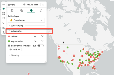

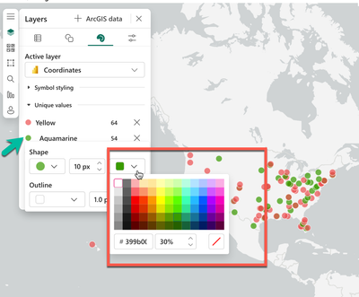

Hi @ShawnBarwick,
Thanks for your question! We use smart mapping when mapping the data so that's why you see the automatically assigned layer styling.  Yes, you can customize the color you want. I assume you add the open/closed data to the Color field well, right? If that's the case, go to Layers and choose Symbology. Under Symbology, select Types for Symbol type. Go to Style options and expand Unique values. Here's the place where you can customize what you want to see on the map. If you click on the colored circle, it will popup a window to allow you to customize your feature. You can change the shape, size and color you like plus the outline.
(Here I changed to Red and Green for the points for demo use only. 😜 )
I hope this helps! Please let me know if you have more questions or concerns.
