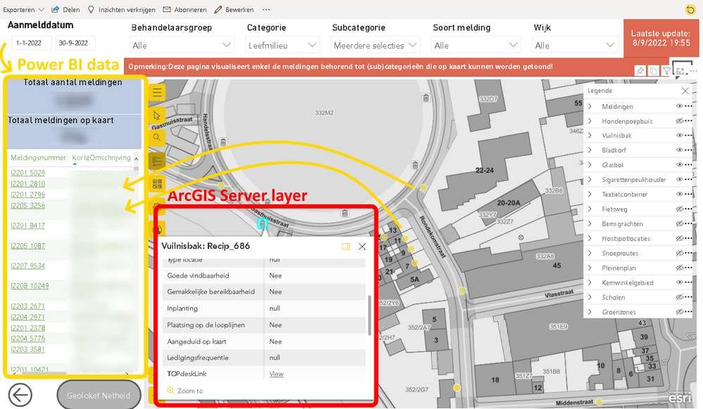

BennyMeyns
Hi Power BI & ArcGIS users,
We've got good news about the Power BI with ArcGIS Server integration:
Since the ArcGIS Online update of june, we've managed to use Power BI (online) and the “ArcGIS for Power BI” plugin with the IWA authentication on our ArcGIS Server layers!
Thanks a lot everybody who was helping to get this stubborn "IWA authentication" issue fixed.
Being able to combine the power of both platforms (ESRI ArcGIS + MS Power BI), will help us to level up to the next niveau!
Benny
