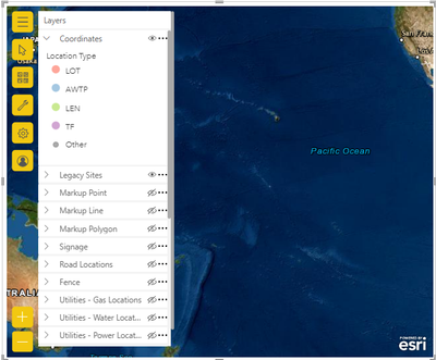

The legend option would be helpful because anchoring the layer list takes up a considerable portion of the map visual if you want to display any other data on your report. A simple legend along the bottom showing one field would be ideal.

Wondering if you could provide an update on this case? It is hard for report users to find the legend, as it auto collapses and it's not intuitive to search for the legend under the field dropdown as per my image above where it is titled "coordinates". Thanks!
