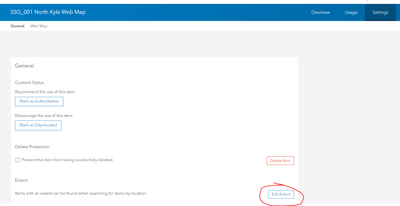

1. The map show the earth, how can I set the visibility range on ArcGis Excel so it zoomed in directly to the parking lots and not showing the earth?

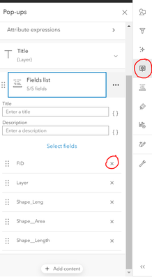

2. Whenever a person in my organization press one of the points it show to much information like rowid, the xy coordinates, how can I make those dissapear?

1. you can set the default extent of the web map in the web map settings:
2. you can edit the popup configuration in the web map by updating in map viewer and then removing fields from the visible list:

1. I can change the visbility range on web map but the issue is when I update my excel layer, it will zoom out the world, is like the excel layer overwrite the setting for the web map. I try to do like the picture you sent me on the layer but it will still be the same.
2. Thank you, It worked so now I have the information I want.
