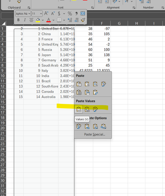

If you do not see data in the map than you can add the feature layer from your AGOL account ( Add layer > add from AGOL). You could also copy/paste the Excel data using Paste with values (as a workaround). See screenshot below -

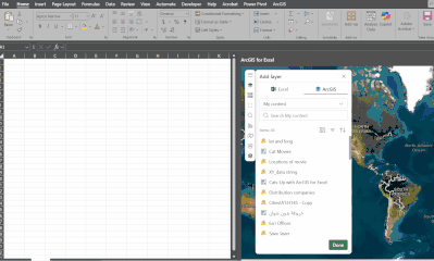

So today after the weekend I opened the spreadsheet and wanted to do some refreshing of new data.
The "Disconnect" I referred to earlier happened and unfortunately I can't figure out how to reconnect the data without doing my workaround.
To clarify, when I opened the Spreadsheet on Desktop the Arcgis extension is on, but the map has been reset and no data is showing. I attempt to logout/login and nothing changes.
I then turn on the layer I previously connected to the spreadsheet, it shows the data but I cannot sync new changes.
I attempt to add the layer again with the + button, but it puts it into a new sheet with a "(1)" at the end.
Clicking on data in the previously connected sheet does not bring up the "MAP" tab like it was doing when I replied before so I do not have any option to "Sync With ArcGIS"

I am sorry to hear that! From your description, I feel as if something maybe corrupt at this point, that is just my guess. Are you able to DM me and share your worksheet? If not can you use Fiddler or Dev tools (although I think you are using DT) to capture what maybe going on behind the scenes?

As for problem 2: Let me see if I can explain it better. Currently I am syncing data from a map to the Excel. Sometimes when I open the spreadsheet the "Add attribute table to excel" button has been unchecked
WMANDD_1-1751477529620.pngand I cannot sync new changes to the Excel drawing. Most of the time that button stays green and I get "Sync updates" as normal.
Maybe I was missing something on how to fix that, but if I attempt to add that layer that has the button unchecked, I get the error, and need to do the workaround. Though with the Map Data tab I notice there is a "Sync With ArcGIS" button and that might've fixed the problem.
