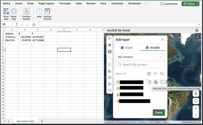

After some additional collaboration, here is an optional workaround @MissouriOffice_of_Geospatial_I  -
  1. Sign in to your ArcGIS account
  2. Go to "+Add", and choose the "ArcGIS" tab, then search for the layer containing the ArcGIS data that you need
  3. Click on the table icon next to the layer name to add the layer's data to Excel
4. The data will be added to Excel on a different sheet ("ArcGIS data sheet")

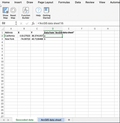

5. Go back to the sheet with the geocoded points. Use cell references (=sheetName!cellName) to create a new column that links to the data from the ArcGIS data sheet.
6. The geocoded points data is now linked to the ArcGIS data on the "ArcGIS data sheet". To sync the data from ArcGIS, go to the ArcGIS data sheet and make sure the Excel cursor is on the ArcGIS data. The "Map Data" tab will appear. Click the "Sync with ArcGIS" button to bring any data updates from ArcGIS.
