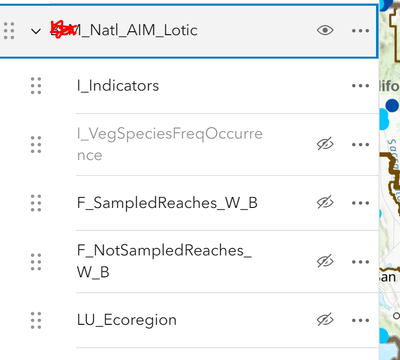

Thanks again for posting your question. It is a good one. From the first screenshot, is this taken from Map Viewer? If so, I would need to understand how this was created. Did you group layer items or ?

First image is map viewer yes.  It does that when you bring in the entire service at once on its own.

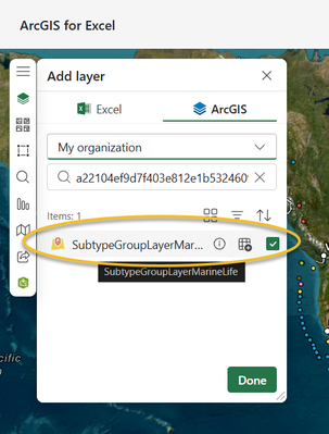

ShannonCardoza
In short, @DougBrowning We will not be able to expand group layers. For example, this layer has groups and I am at Add layer step -

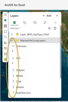

Once I have added the layer, now in my TOC, I can expand -
This is with the assumption you are referring to sub group/layers and not 'groups' in your organization like this -

Sorry been out.  I am seeing it when there is a group in the map it thinks its an imagery layer?
In Map Viewer
