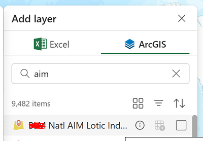

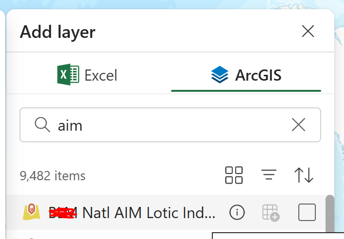

Can guest users add data to the Excel table? Greyed out now.
803
08-18-2025 02:00 PM
DougBrowning
MVP Esteemed Contributor
I thought this used to work but now the add data to excel button is greyed out if the user is a guest.  Same layer works if I log in.  I can add to the map side but the data side no.
Is this a change?  Do you need an account to add?  I tried a free account also and a no go.
thanks

DougBrowning
All our services are read only no editing.  We just wanted to be able to have the public add our ArcGIS Hub data and see the table in Excel.  I thought it used to work.  Bummer.  thanks
