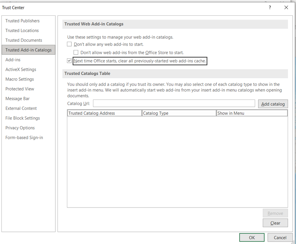

Please check whether clearing the cache solves the problem - In the Excel, Go to File Menu -> Options -> Trust Center -> Trust Center Settings -> Select the checkbox "Next time Office starts, clear all previously-started web add-ins cache". Restart the Excel.

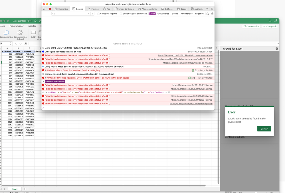

Thanks for your reply. Please find below the error:

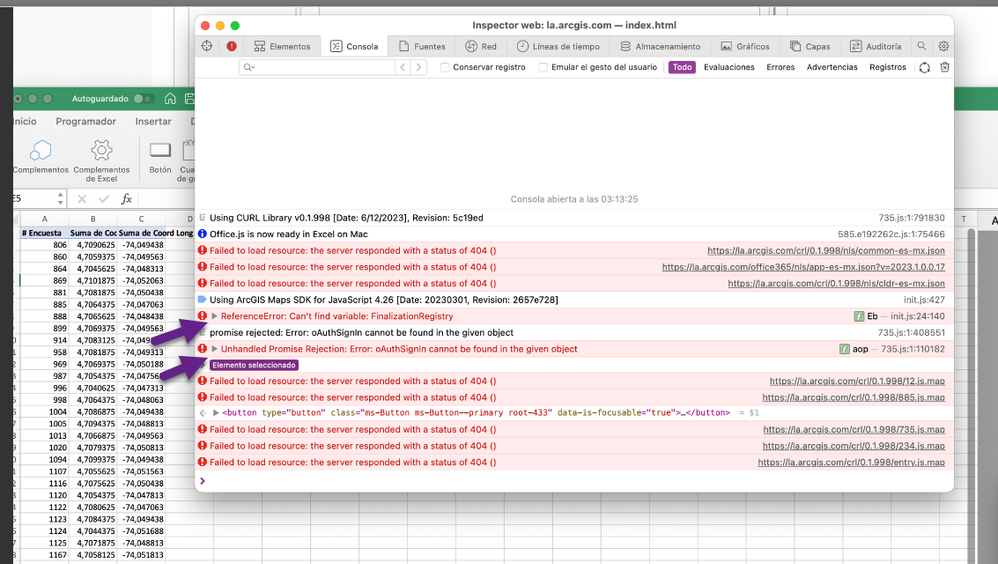

Thanks for sharing the Dev console errors. Please expand the below error nodes (can't find variable and unhandled Promise rejection) and send us the errors screenshot.
