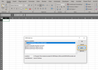

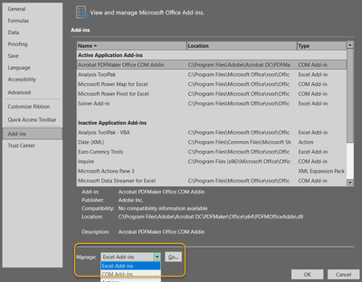

@MelRoyer I found a few resources that may be helpful, see below:
From my understanding, you would be going to File > Options > add-ins > Manage > select COM add-ins from drop-down -
Just keep in mind this workflow will need to be specific to your environment and needs. I would refer to Microsoft help for support for additional guidance.
