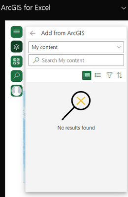

We are trying to get Excel For GIS up and running for our employees and all the references mention a "Add Attribute Table" toggle is present and active for Add From GIS when you add feature classes to the map pane. We are not seeing the toggle for our feature classes and have even played around with editing and sync settings to try to get the toggle to appear. Below is a screenshot of our Add From ArcGIS window and we are using the AGOL login credentials to access our information. I am having a hard time finding information on trouble shooting this problem, so any help is appreciated.

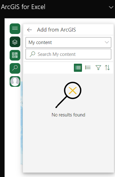

@ShannonCardoza I'm having the same issue of no toggle button even though I have a Creator license. This seems like such a great tool if you can view and edit the attribute table, but right now I can't. Can you advise what the solution might be?
ShannonCardoza
@CatherineRiihimaki Thank you for reaching out! I am going to take a guess and ask if you can double-check which licenses you have assigned to your profile (username) . I suspect you may need to 'assign' the office app, ArcGIS for Excel? Or you may need to see which role is assigned to your profile (username). See example below -
Please let me know if this helps!

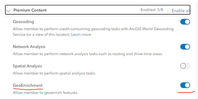

Evan_Sepa
I believe I narrowed it down further to simply the "GeoEnrichment" setting under Premium Content.
I created a new role and imported the "Data Editor" settings. I only added this function and it seems to work now.
I already had a credit limit of 10 for these users, but I would assume this should not be 0.
Cheers!
