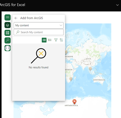

@ShannonCardoza When I select any feature layer from AGOL while using ArcGIS For Excel, I can pull in the layer, but I am not seeing the "add attribute table" at all (see screenshot for reference). It pulls in the layer but all I see is the legend which I can toggle on and off, but the table never comes through. My excel sheet remains blank with no new tabs. What is the best way to trouble shoot this.

@SaraVanNingen1 Good morning! The 'Add attribute table' will be accessible if the correct role/permission is assigned. I believe it needs to be at the Creator permissions level. Creators can create and edit content such as maps and apps, perform spatial analysis using the analysis tools in ArcGIS Online, collect data, and collaborate and share content for use in apps. We need the 'access' to use the analysis tools. Can you verify what role is assigned?
See the User types for more information and let me know if this fixed the issue.
