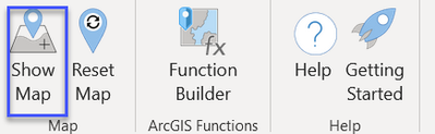

  1. Open a Microsoft Excel sheet.
  2. Access the ArcGIS tab.
  3. Click the Function Builder button.

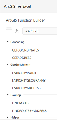

The Function Builder opens in the Task pane, with parameters listed under categories.

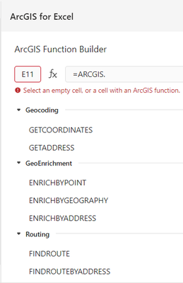

Note: You need to sign in to ArcGIS to access the Function Builder tool.
4. If you have chosen a populated or an empty cell, the selection or an error displays before you can proceed with a function selection.
5. Choose a function you wish to run from the following options:
NoteOnce you choose a function, the Task pane is populated with the chosen function and related fields and drop-down menus. After populating all parameter fields, you may choose to click, for example the Include column headers checkbox, then proceed with running the function by clicking  Insert. Depending on which function is selected, there may be additional options to check on/off.

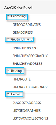

6. Choose a function you wish to run from the following options:
Geocoding functions:
Parameters: (all fields with an asterisk, are required)
GETADDRESS
GETCOORDINATES
Geoenrichment functions:
ENRICHBYPOINT
ENRICHBYGEOGRAPHY
 ENRICHBYADDRESS
ENRICHBYPOLYGON
Routing functions:
FINDROUTE
FINDROUTEBYADDRESS
Geometry functions:Parameters: (all fields with an asterisk, are required)
Helper functions:
SUGGESTADDRESS
GETGEOMETRY
LISTGEOGRAPHIES
LISTDATACOLLECTIONS
LISTTRAVELMODES
This function has no parameters. It is already done and displaying results in your chosen cell.
ADDHEADERS
