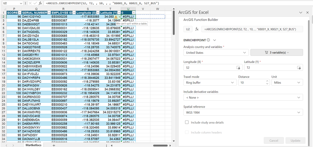

Running the ArcGIS function formula within the Excel tables or in the column directly to the right side of the Excel table causes the #SPILL! Error.  The cause of this behavior is a limitation within Microsoft Excel where running the formulas are not fully supported in the Excel tables, please check the link for the workaround.
