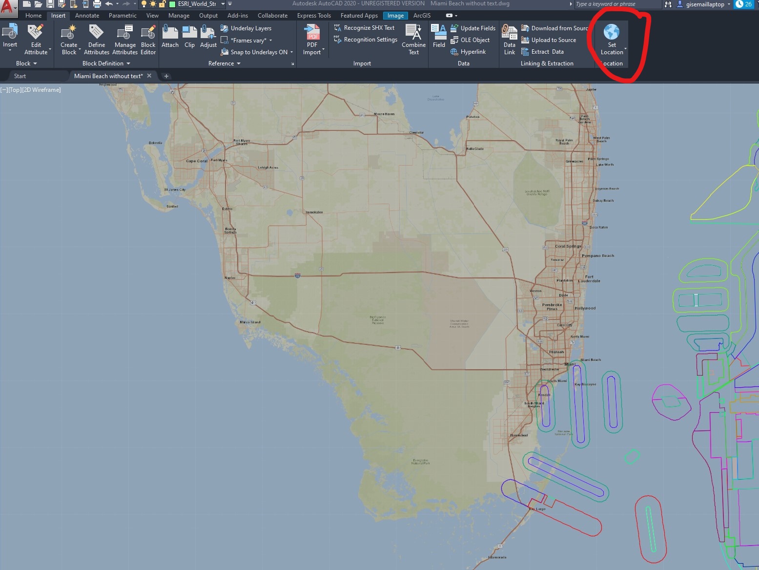

I am having a scale problem with my ArcGIS for AutoCAD 370 basemap.
My AutoCAD Drawing is really big compared to the basemap but it has the correct measurements and the CAD file is in the correct location. #arcgisforautocad.
Using NETLOAD I imported ArcGIS for AutoCAD 370 and by selecting Add Service I assigned a projected coordinate system UTM WGS 1984 17N  in a World_street_Map since the drawing is in Florida but I never did anything else in regards to the units of my map.
To solve my problem I tried changing the GIS coordinates drawing units using the location tool but it didn't work. The next images show what I did

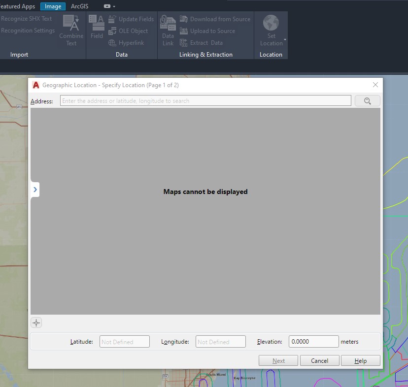

Once I opened the Location tool and I select "From Map" this is what I see:

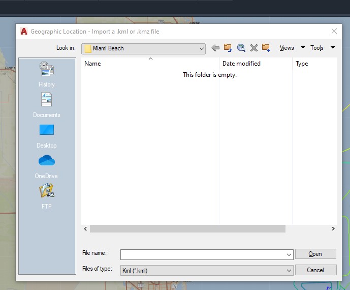

and if I select "from file" I see this:

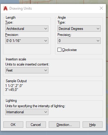

My autocad drawing units are set as follows:

It looks like you are setting the coordinate system using the AutoCAD coordinate system picker. Unfortunately in ArcGIS for AutoCAD 370 we do not support setting it using AutoCADs tools. You will need to go into the ArcGIS ribbon tab and set the coordinate system using the Esri's Coordinate System picker (as shown here) Once you do that the map should project and assuming your drawing is in the correct units, scale and location it will line up with the data:
