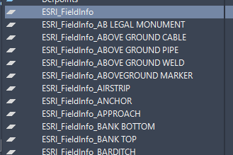

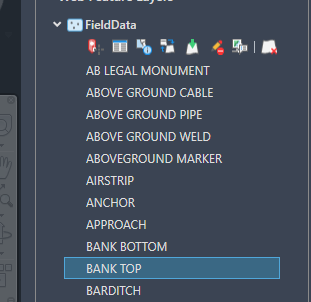

It would be great if we could have a checkbox when loading web feature layers to ignore the symbology set to prevent a CAD Layer being made for each one.

DerekBannon22
Hey @MichaelDavidsonPM,
I updated the my layer to a new symbol layer called ESRI_FieldInfo and saved it to a template and it just came in under that layer and still made layers for each symbology group which is what I am trying to avoid. I believe the same thing would happen with a LISP routine. I have a ArcGIS for AutoCAD question posted currently that explains a work around that I am currently doing to alleivate this issue as syncs take a long time on web layers that have a lot of sybmology that get broken down into many CAD Layers.
