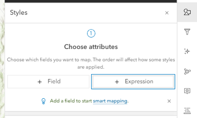

You can Arcade to change the symbology in the Map Viewer by selecting Styles and then selecting Expression:
