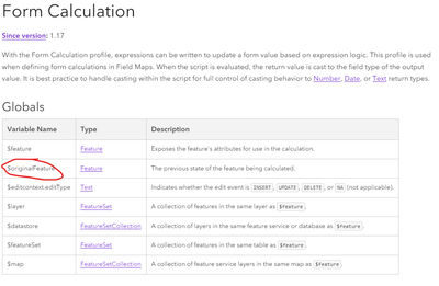

you can give the "$originalFeature" variable type a try to help with this.  you might be able to get the previous state of the field and reassign it.
Also, perhaps a helper field that you keep visible at the bottom of your form that has a calculation that only executes with the state of any switch is toggled and stores a dict representation of the state of your form.  If the a switch is turned on and hides fields it records the previous values of each field that is subsequently hidden... if that switch then turns back off those values could be used by calculations on your other fields to restore their values.  I have not tried this, but seems sound in theory.
