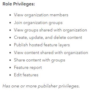

The user that I want to be able to modify these lists has the following privileges:

What privilege does this user need to manage the list?

  • You'll need to add the Administrative privileges > Content > Update privilege
  • However, even when you do that, there's a bug in Field Maps (and probably Online) in that, we're not honoring that privilege to allow you to update the List (i.e. Coded Value Domain)
I've got an issue in our backlog to address for the Fall release of Field Maps.

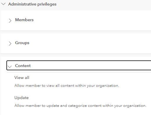

Regarding setting the privileges, "Administrative privileges > Content > Update privilege" - it looks like this (see below), which I find very confusing.
CraigGillgrass
Sounds like this will continue to be a known issue in the Online Data tab but we'll address it in Field Maps.
The Update privilege is the one you want to enable for this to work once we address the bug.
Craig
