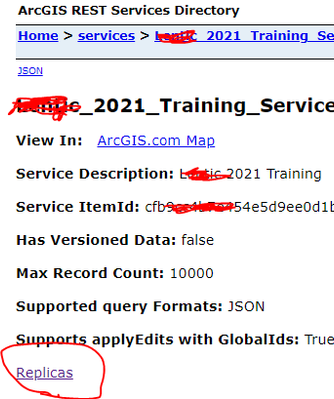

You can check the replicas and it will tell you.
The manual way is in the service page click on Replicas
You will get a list of all that are active.  Each one gives you the user name.
