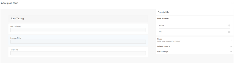

I created a WebMap with a simple form. Notice, you cannot create an entry for an attachment.

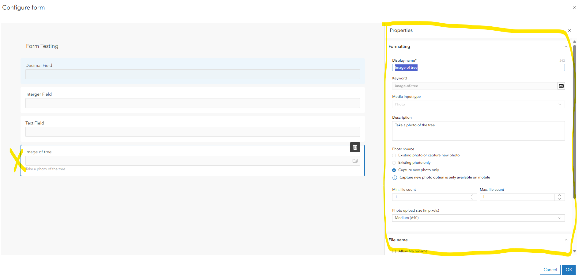

Now, watch the magic that happens when I manipulate the JSON based on the WebMap Specification to create an extra entry in the form for capturing an image with some manners (naming photos, number of photos to be collected min/max for examples)
Unfortunately, that is where the magic ends 😢

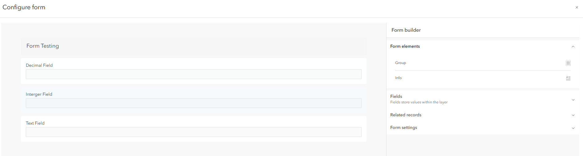

When you open in Field Maps we are met with "The form contains unsupported data".
