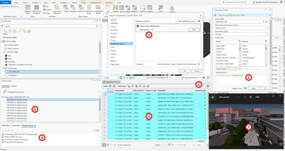

Hey Nancy,
In order to see the attachments in ArcGIS Pro you need to select the features of interest and open the attribute pane and browse through the list of selected items in the pane (using the up and down arrows works well).  If a feature has attachments they will show up in the attachments tab in the attribute pane.
I'm with you that it would be nice if ArcGIS Pro had an attachment viewer or manager, or suite of built in tools to help that way there was something readily available and intuitive. I didn't dig too deeply, but doing a quick search for ideas on the subject here in the community I didn't come across any posted ideas for such a thing so that might be a good one to post.
Given that the attribute pane is about the only option in Pro, if I had to review and process photos in Pro I would spend a few minutes getting things setup to improve the my workflow a bit.  It would look like the following. 
  1. Create an integer field (short or long) to hold the number of attachments that a feature has.
  2. Calculate the field by counting the number of attachments using a 1 line arcade expression
  3. Filter out any features that do not have attachments
  4. Sort the features by the number of attachments and select all features
  5. Open the attributes pane & select a feature (the button can be found on the ribbon on the Map or Edit tabs)
  6. Click attachments then double click to open the attachment.
Steps 5 & 6 are the only steps needed to see the attachments, steps 1 through 4 are quality of life.
If you are wondering how I changed the display name of each feature in the attributes pane to show the ObjectID and the number of attachments this is done in the layer's properties. Below is an example.
