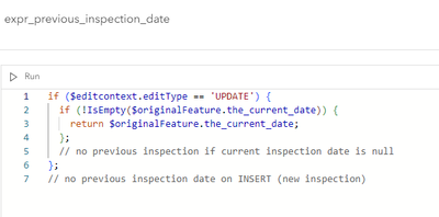

Assuming you're creating and updating the same feature (not related records) you can you $originalFeature on Update.  $originalFeature contains the attribute values as they were last submitted to the database.
In this example I created two fields and added a form calculation to the the_previous_date field.
  1. the_current_date
  2. the_previous_date
Example: Using $originalFeature to access attributes from the previous form submissionExample: Using $originalFeature to access attributes from the previous form submission
// check the editType becuase $originalFeature isn't applicable on INSERT
if ($editcontext.editType == 'UPDATE') {
  if (!IsEmpty($originalFeature.the_current_date)) {
    return $originalFeature.the_current_date;
  // no previous inspection if current inspection date is null
// no previous inspection date on INSERT (new inspection)
And here is what it looks like:
