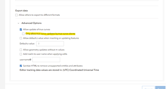

Is this Portal?  We have been seeing this setting here getting turned on by default now in Portal and we have to turn it off.  Not sure why its suddenly doing that.  It caused what you are seeing can edit online but not offline.
Hope that is it
