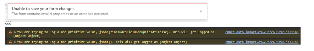

I have been working on a fieldmap app for a few weeks until suddenly a few days ago when I went to make a change to the and save the below error appeared stating that it was unable to say my form changes.
It is telling me to check the layer settings and confirm that I have the privileges required to make changes.  The layer has been set to allow editing and I am an administrator.
Is there something I am missing here?

For me it turns out the issue was the Shape_Length field being included in the list of fields - once I removed that, I could save the form.
I don't quite understand why it had added itself, as the polygon layer didn't add either of Shape_Length or Shape_Area when generating the form - perhaps a little big Esri side..?
So long story short - perhaps try running through the fields one by one and see if any have the red asterisks in the Properties/Formatting pane on the right and remedying those, or removing the problem fields completely.

Same problem. I just removed the attribute "Shape_Length/Area" as they are write protected. Works fine now!

Another helpful note - today I was getting this error. Turned out there was a Domain with two identical Descriptions. Apparently that causes this error.  There was 14: Grease Trap and 15: Grease Trap for a sewer structure point layer with a domain categorizing the type of structure.

I also got this error while working in the Field Maps Designer.  Opened up the web map and edited the Smart Form their and was able to save successfully.  Console error I had below: FM_error_1300494.png

I just encountered this error with a hosted feature layer that is part of a field group with contingent values originally set up in Pro. After much experimenting I finally found the issue was a duplicate domain description- the codes were unique, but two codes had the same description text. This somehow caused the error in Field Maps Designer. I could add the form element for the field, and save the form, but if I tried to edit the element properties at all, it would throw the error and the form would not save. After making the domain descriptions unique, the error was gone.
