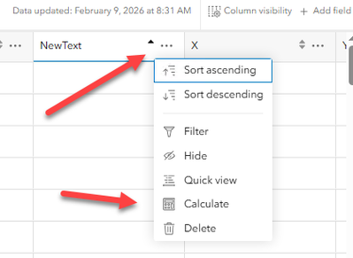

RhettZufelt
MVP Notable Contributor
Sure you can.
Just go to the Item Details page, Data tab and you can do it there.
R_
Pukawai
No, that calculates a field based on some expression you have to build, not the one that is in the layer's form.
