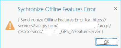

I am attempting to sync an offline area. I am receiving the General Error - Request Forbidden on one of my devices. Three other devices for the same area do not have this issue. What is the solution for this and what could be the cause?

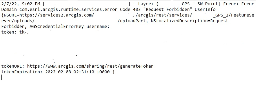

I am now receiving this error on another device for a different offline area that until today had no issue syncing.
In the logs it is showing the following.

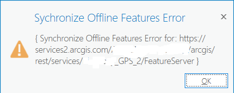

However I am receiving the following error in Pro when attempting to sync the other area.

@AC13 there was no solution from ESRI. I ended up having to pull the mobile gdbs from the devices directly. Determine what had been synced to the main hosted feature layer and append the data from the mobile gdb back to the hosted feature layer.
